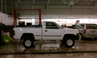

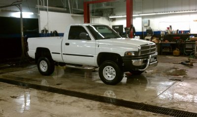

First off i am new to the forum. I have had my ram for about a year now and the last couple months i have been doing some upgrades. I have a 99 dodge ram reg cab short box 1500. I recently put 3/4 ton springs in the front and an add a leaf in the rear. problem is , the rear isn't setting much and i got a bit of rake going, and i don't like it. I got bilstein shocks for a 3 inch lift in the front. and bilsteins in the rear. I want to add a 2 inch coil spacer along with lower control arms, drop pitman arm and sway bar relocation brackets for the front. Do i need to buy longer shocks again or am i okay? I don't want to drop another $180 on shocks when mine are still brand new. any input is greatly appreciated. I'll try to add some photos of it to this thread.

This is kind of a half arsed setup and you're trying to repair it cheaply. Cummins springs were never meant for a 1/2 ton gasser, and rather than buy spacers
I would junk the springs and get a set of 5 inch springs for your truck. This will rid you of most of your rake.
5 inch springs (or spacers with your old springs) are going to need both upper and lower arms so your caster can be set properly and your axle centered.
You'll need either a tuff country track bar mount if you go with a stocker or a much better track bar which isn't going to be cheap. A Bilstein dealer can tell you the extended length of your shocks and if they will work. They're likely long enough but not for any serious off roading.

I think it looks okay looks like it is made to work. A little take will be nice when you hook on a trailer.
