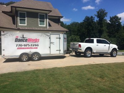

Not sure what kind of weight your buddy had on the hitch but with 500 lbs on the hitch my truck w/3” Superlift coils handles the weight WAY better than the stockers, no case of the squats at all.
