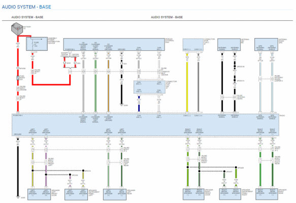

I just purchased a 2014 with the base system too, and I'm planning out my system. From what I've read, the front door speakers and dash speakers are wired in parallel, so that's gonna cause you issues with wiring in your components.
I'm in the same boat as you. Leaning towards doing components in the fronts as well and trying to figure out how to keep from running new wires through the doors. If we knew where the "junction point" is in the wiring, we could undo the loom and split them off and place the crossovers there. Just thinking out loud...
