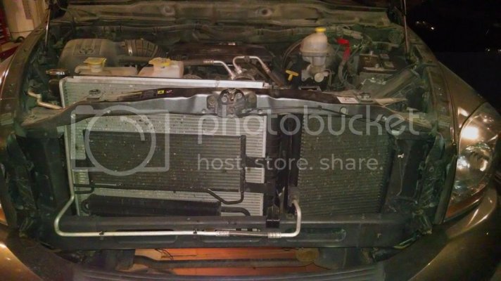

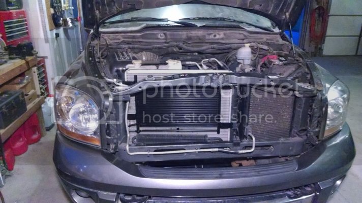

You'll definitely want to get the brake controller and get it wired properly like Justin says. You could also upgrade the transmission cooler to be on the safe side. The first pick is my factory trans cooler that I got with the tow package, second pick is a 2003 heavy duty trans cooler. It wasn't difficult to install and cost about $225. I'd also check the load range of your tires to make sure they're rated for the weight you'll be hauling.
