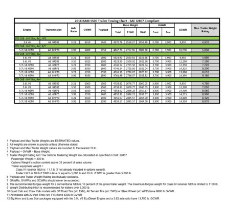

Here's the chart for your model. As long as you stay within its limits you should be good.
