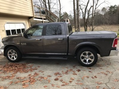

First time Ram owner, but not really new to trucks. My subdivision has a lot of hills and valleys. It SEEMS like when going slow and on a downhill slope, it doesn't really want to upshift. RPM's go to like low 3's doing around 20-25mph. It seems "sticky" but my gut tells me it's just the way Ram is. Is that pretty much right?
I've tried using the "gear up" button, but it doesn't seem to work, although "gear down" seems to work, and then you can, I think, gear up (have to read the manual more on that function)...
It's a 2015 Laramie with the 5.7 and 8 speed trans.
Thanks!
Edit: if I go a bit faster down the slopes it will upshift, but I don't want to be doing 35-40 in a 25mph neighborhood with a fair amount of kids around.

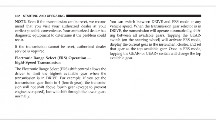

The gear up and down buttons are for limiting the highest gear your truck will shift into. The gear up button will not force an up shift beyond what the trans controller seems is the correct gear for the truck to be in.
Not technically true.
There's a "gray area" where hitting the button will actually cause the truck to upshift whereas otherwise it would just sit in 7th. I've had it happen several times when towing up a low incline after a medium one. The truck won't upshift on its own until it's more or less on a flat surface, but if I hit the button it will go to 8th and just lug the motor.
Either one of two things is happening, the TCM is allowing your transmission to upshift to 8 gear when you tap the Gear + button based on rpm and torque demand or there is something wrong with your transmission.
In case I explained it wrong:
(due note I didn't mention to engine over speed will force an upshift past the selected highest gear)
Dubstep Shep
Aug 4, 2014
2,240
514
Houston
2014 R/T
I understand, but if you read carefully you'll notice the language in that picture doesn't exclude what I'm talking about.
