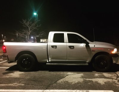

Hey guys i just picked up a 2016 STL that had the RA1 radio , I just recently upgraded to the RA2 5.0 Uconnect touchscreen . I just ordered and picked up everything to put audio controls on the steering wheel (AKA just bought a new wheel with all the controls on it including the voice and call button ) the question i have is will i need to have a reflash to allow all the new gooides to work ? or should it work no problems ?
Also being new to the game, does anyone have problems with poor audio quality while bluetoothing music ( I have an apple ) but i stream though Spotify. Ive done some research but the latest thing ive seen was from 2014, so i assuming they fixed the problem.
