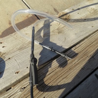

This is my modded garden sprayer,mines the 1 gallon variety,but the 2 gallon versions work good to.I made up a couple differant ends for differant uses,like getting diff fluid back into my wifes Challenger with a diff brace on it.
