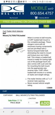

He said I just need to get 2 5/16 tow ball for his trailer. I have the Class IV hitch on my 2018 Express ... I know it has 8000 towing capacity and his trailer weight is around 6000lbs.
I do have my truck leveled with Bils at 2.8 in the front with NO rear spacer. Will a standard tow ball like the following get me by?

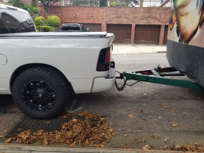

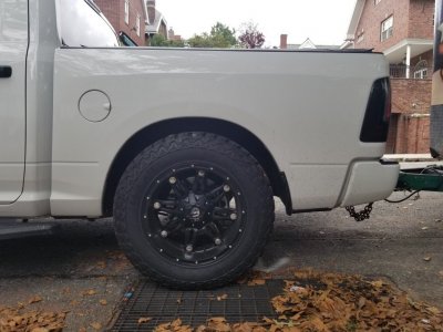

The Trailer definitely put the ass of my truck down pretty low, but as a reminder I had leveled the truck so I had eliminated the stock rake. If I do this more often I may look into something for the rear whether it be bags or heavier springs. Would a spacer suffice? Driving while nose up didn't really seem too much different from my normal driving.

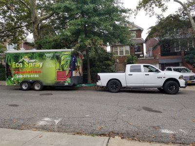

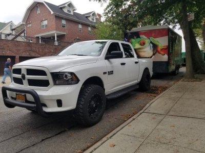

Anyway I posted a few pictures so any experts out there can tell me how "bad" or "acceptable" the set up is.
Like I said, this is first time, so the more advice the better. And thanks for all the advice I've already received.

I personally would not run with that much sag. Any significant bump, even at lower speed, could bottom out the suspension.
A spacer would help but it won't level the truck. You'll be better off with an air bag setup.
Or, better yet, tell your buddy to get his own truck! :D

Understand the trailer would be covered for liability only, not physical damage. Ie Collison damage to the trailer would not be covered. If you hit someone with the trailer the other parties damage would be paid for by your insurance. I'm very surprised there's not a business exclusion or something.
Yes way too much sag. You need wdh or air bags or possibly both. If you don't want to do bags, maybe just try a cheap harbor freight wdh and set that up properly (search threads here by verndiesel) and see how it is. May be good enough with just wdh? Won't know till you try it.

Its low as predicted. WDH and try a set of bags or springs. Tuff Truck springs are what i went with.
https://tuftruck.com/products-results/?part_make=7&part_model=117&part_year=68
https://tuftruck.com/products/ttc-1211/
1211 put you up 0.5 inch from stock unloaded. much less sag than your seeing loaded. You most definitely are hitting your bump stops at times. The 1223 will be too much unless your towing fulltime. the 1223V's are good but will be shorter than stock unloaded. I wouldn't even look at the 1210s.
on spacers:
If you put in a spacer, you just over compressing your springs before it hits the bump stop and they will be sagged permanently in no time. does nothing for the ability to handle the load. It may put your headlights more level but it won't be for long.
Hitch first and put some weight back on your steer axle.
