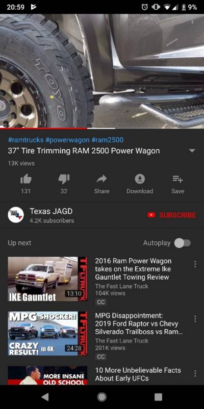

Yeah man 2500 offset is a different animal. I just ordered wheels for my new power wagon and the sweet spot seems to be +18mm to +27mm. I went with +18mm XDs. Where does it seem to be rubbing? A common spot is into the rear pinch weld of the front wheel well. The screen shot is from a YouTube video of a guy trying to fit 37" on stock suspension with -12 wheels. But I have heard of guys still having issues with negative offsets wheels even with a level. Does look good though!

Hate to link another forum but over on PW registry there are quite of few threads on -12 offset wheels and it being hard into the pinch weld on stock and leveled PWs. I'm pretty sure a stock power wagon is already higher from the factory than a normal HD. Depending on how bad the rub is you may be able to just heat up and push some plastic in a little or possibly have to trim it and the pinch weld which seems to be the common spot for rubbing issues.
