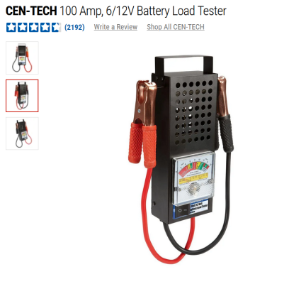

Have you load-tested your battery using something like a carbon pile tester? A regular volt meter won't do it, you need to test the amps. That would be my first place to try. You could have a failing battery that won't charge properly. Maybe also test the a output of the alternator.
