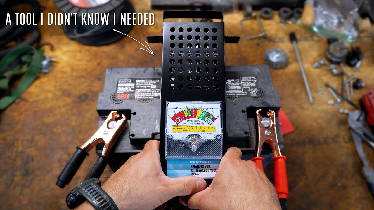

Before you start throwing parts at it,load test the battery. Buy one of these old school toaster testers,they're still one of the best tools a home mechanic can have in their toolbox,plus they're alot better then the digital testers most places use now-a-days.
