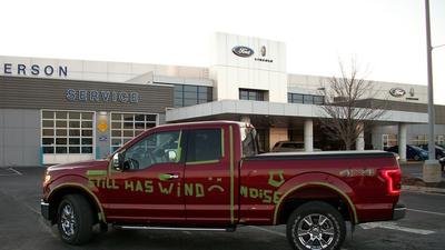

They make them loud so you can't hear the wind noises and whistles they make from the poor workmanship used to assemble them. Here is what I traded in on my 2016 Ram.
