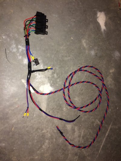

that would do it. that is one of the reasons i recommend installing a relay harness on any old truck especially if you are daily driving them. the weak spots in the electrical sometimes show up like that.
Already ahead on that one. Made this harness and installed it.
crazzywolfie
Apr 6, 2013
16,646
3,430
under the truck
81 93
5.2
looks good but seems like you are a bit late tho lol. at least you shouldn't have any future issues with the lights and they should be noticeably brighter.
