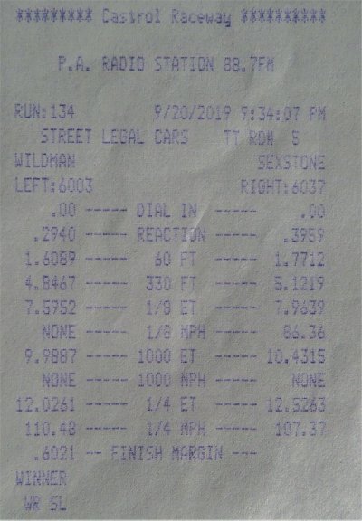

Jay Greene 1.5HL cam / Ma Mopar high performance valve springs / new style lifters (aka Hellcat lifters) / Trend pushrods / Mopar rocker shaft tie bars /Stanke rocker shaft collars and billet aluminium MDS plugs / ARP head bolts / 3.55 gears / True Trac limited slip / stock convertor in the 8 speed,but could really stand a bit more convertor. Back when i put the truck together Jays 1.5HL was about the biggest cam available for the VVT engines and there were no high stall convertors for the 8 speed,now there's a **** pile of cams and convertors to pick from though. It's mild enough anybody can drive it,but it'll run 12.0's all day long at 4,000ft DA.Left lane #6003
