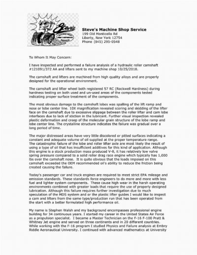

Something that happened here I believe also proves it is NOT the lifters or cam, and that was the lubrication strategy tests. Clearly these strategies do work and are not related to viscosity, but additives. So if the cam and lifters were "junk", how could have hemi tick gone quiet in 80% of rams that adopt a high ep/aw base oil strategy that is the same viscosity in many cases as before? The best part, in the worst group you can chose, IE trucks with hemi tick, not one- knock wood -has had a cam fail, 100's of rams that tried this strategy. Now disclaimer, I incidentally heard one case like this week but I havent had a chance to follow up, so possibly one case out of well over 100 rams with hemi tick over a decade. What are the chances if you find lets say 150 hemi tick rams right now and didnt do this strategy for none of them to have a cam fail in a decade? Yes it doesnt prove anything if you need an XYZ = PROOF, but it surely hints at it? Thanks to ram forum members who bought into this and followed through over the year, members just trying to help each find at least options if not answers.
I think it is clear as day what causes these cam fails and hemi tick, but I don't know to the exact why, but only one thing explains everything and reconciles why we had success following the theory of EP additives. There is back pressure on lifters in the bore, this even explains why some needle bearings fail. When the cam lob hits the roller in the cases of cam damage and hemi tick and explains every single thing, the lifter fails to lift easily in the bore, it fails to lift as easily as it does in the healthy examples of hemi's. I'm not a mechanic, I don't tear down engines all day every day, I would imagine if I did I could have a decent idea to the why, but that is not my deal. In my opinion every arrow points to this fact. Lifters are pretty much dumb tech, the only moving part if the roller, and because maybe 10% or so of lifter fails do involve a roller, it confuses the root cause.
If anyone has a different opinion, that certainly is ok, I just have seen nothing that has me coming off this in 10 years. I would love to know more, if anyone has a different opinion post it, see if we can hash it out and learn something.
I hate mds, cant stand it, just one more thing that can break, but it isnt the bad guy in hemi tick. And I do have a question for someone who knows, is mds active at idle?

thanks for this article as I havent seen it (and I know this topic is belabored here and elsewhere) but again appreciate you and the article for my own purpose.
there must be a reason for several revisions of the lifters - but I understand that's debatable. I beleive in Mopar, have for a long time, and I also believe/ hope that the upgraded lifters will help solve some of the problem
I get that oil starvation/ stiction likely contributes highly to the catastrophic failure of the lifter so I kinda think we are on the same page - its an oil starvation issue - most notably to the #5, that is at the root of the problem.
Unfortunately I am not at a place dollar and time wise to do a full engine tear down and get the oil galleys modded - so my thought process on deleting the MDS is that its the best thing I can do to support more constant oil pressure.
Maybe I'm wrong here, but my understanding of the MDS system is when it kicks on/ off there can be disruption to the oil pressure in those cylinders - I can at least wrap my brain around that idea - which seems like it could contribute to starvation, and since I see really no benefit to the MDS system why keep it?
Thats a sincere question; aside from 'fuel economy' is there a true and clear benefit to keeping to MDS system?
I fully agree that higher quality lubrication/additives can lend hand to the issue as well - it appears you support Redline? Is that correct?
