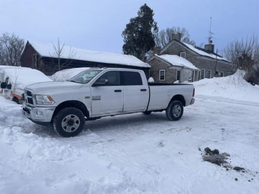

All seems to be well, I brought the truck home, runs great, I would say quieter than before, probably due to the broken exhaust manifold bolts. A little bit of smoke but thats form the valve cover leaking, it leaked out about a quarter of a litre and it ran over the exhaust manifold. Just going to keep an eye on the coolant over the next few days and if it holds its level then I’m home free. Can’t thank everyone who helped me out here enough IMG_3304.jpeg. Big thank you to @Wild one, couldn’t have done it without out your help, I see I forgot to put the center hub cap on.
Jan 17, 2016
23,817
54,819
14 Sport
Awright way to go Burt,it's nice to actually see a pic of the truck,lol.
Hopefully the oil leak is nothing serious.
