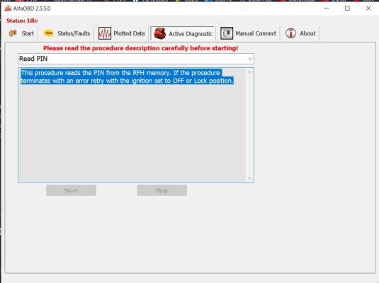

I've heard of that "login card" as a vehicle PIN code, but this must be Alexey's version. :cool:
On the older vehicles, AlfaOBD can reveal this code by connecting to the RF Hub module..
