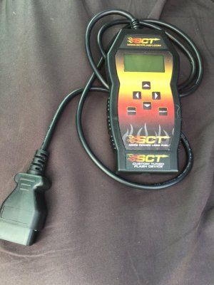

Tuner -
I answered many questions and Hughes built a custom profile. Two. One for street and one for towing.
