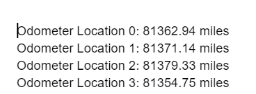

Reviving this thread for future lookers and maybe the OP if they see it...in AlfaOBD the "Engine" info log (in my case PENTASTAR_INFO.log) has 4 reported mileages in it from different module locations (none of which match each other). I'd have to run the report to see if it matches the odometer in any of those but my guess is "no".

I'll try and run this on my GC and see if I have the same results. I was unable to pull any different modules other than pcm (matches cluster odo) with any of my scanners (xtool, autel maxisys). Heck, I didn't even see any others on my witech.

Same as @SitKneelBend.. came up all modules, slightly off within a few miles.
