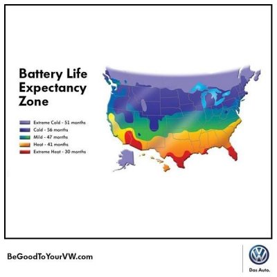

I run an Odyssey in my 2020, the difference between mine and the extreme is negligible.

Old post. My OEM factory battery is still going strong after 49 months since it was first sold. It might have to do with its use in a "Cold" location.

I live in the area between Extreme cold and cold and have had pretty good luck with oem batteries...the secret is I get the car itch all too often and rarely keep one over 2 years lol.

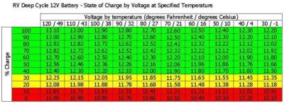

Calling a factory battery "junk" is quite a stretch. Open cell voltage of 12.6 Volts is a full charge. Extremes in temperature are the factors that will kill batteries sooner. In my 40+ years of owning new vehicles, factory batteries have never been an issue.

I recently checked three fully charged batteries, two were flooded lead acid deep cycle at just above 11.9 volts parked outside and the third was an AGM starting battery at 12.06 volts with the car inside an open garage. The outside temperature was 10F. 12.6 volts is a full charge at warmer temperatures.
