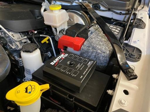

One of the first things I usually replace on a new vehicle build is the factory battery. Being new to Rams what is the recommended solution here for a high quality main battery that can handle reasonable cycling from running accessories and vibration on the trial. I’ve been a fan of Odyssey batteries in the past but would prefer a stock drop in solution with minimal to no modifications.
As for dual battery set ups, I have transitioned away from that in favor of lithium solar generator systems for the camp environment. So really I’m just looking for a quality replacement of the factory battery which I assume is junk. Any suggestions for this overlander?

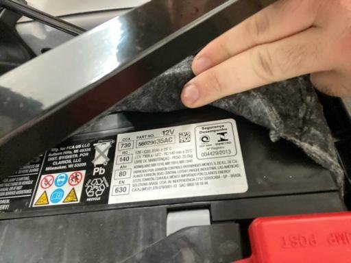

Here’s what’s in the truck now:

Per the part number on that battery, it's a 94R (H7) battery, the Odyssey battery is a 94R-850
https://www.odysseybattery.com/products/odp-agm94r-h7-l4-battery-94r-850/
https://www.autozone.com/batteries-...ery-94r-850-group-size-94r-850-cca/937704_0_0
I know it was reported in the past the Odyssey 49-950 would fit in the Gen4 HD trucks. It's a H8 size battery that's about 1.5" longer than the stock H7.
https://www.odysseybattery.com/products/odp-agm49-h8-l5-battery-49-950/
I have the 49-950 in my '15 EcoD, that was the replacement for OEM battery size.

I installed the 94R Northstar AGM Battery. This thing is amazing. Perfect fit...like in every way perfect fit. Someone mentioned that you can go up a size in the battery tray, that is not the case for the 2020 Ram. The 94R takes up the entire tray and there are no extra knockouts to remove. Anyway, this is the best AGM available for this truck IMO. BTW, I measured voltage right after install and it was 14.2 volts. Plenty for this battery to charge fully. I do have the dual alternators.
