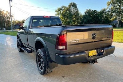

I like my tires to sit just flush (very slightly inside) the fenders, and this should help. I had 20x9+18 wheels on my 2015 2500 with OEM fender flares and it was "just right."

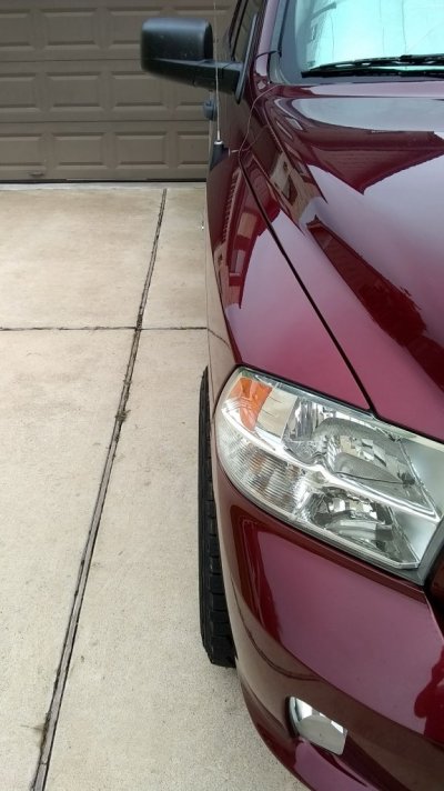

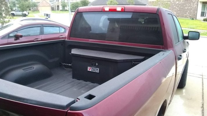

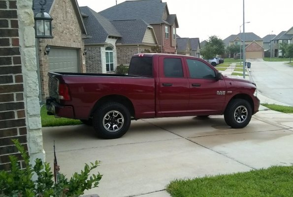

I bought and had installed the 2017-era Rebel wheel replicas (DG55) seen here:
I wrapped them with LT285/70R17 tires to match what the Rebel was running because I knew it would fit, and they did. Just about flush too. I love them. The only thing that "barely" concerns me is what I first thought was a low load capacity, which OE Wheels stated was 2,105 lbs. However, that's enough for my truck's Gross Axle Weight Rating of 3,900 lbs front and back, so no worries I guess.
@Southbay let me know if you have any questions about them.
