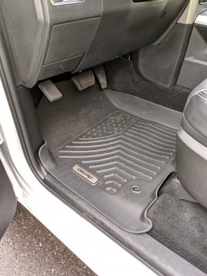

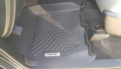

JUST bought and installed the laser cut mats, nice mats, fit nice, i would just make the passenger side go up firewall more. Cant beat the price.
Definitely fit and feel better then my max liners i had in my 08, a little more pliable then my wifes weathertechs.
Edit: added pics!

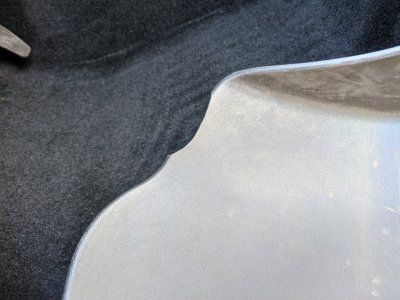

Just wanna put this out there for anyone with the laser cut mats,
I pressed my gas pedal all the way down and the mat held it there! Scared the crap out of me.
These have to be cut like the pic ive included. Personally i think they need a redesign and more material should go up under pedal.
I suggest pressing pedal to the floor with truck off to see if you have this same issue before it happens while your driving.IMG_20190518_080634.jpg

Never heard that before.
We have considered these factors when designing, and we dedicated to providing safe and high-quality mats for everyone.
To figure the problem, would you like to tell me which floor mats do you get? What's your truck? Do you have a picture when the pedal stuck?
Thanks.

I have the laser cut crew cab floor mats
Part # EO1001R021
There is another review on amazon that stated the same problem. I dont have a pic of it stuck, but every time i pushed pedal all the way down it got stuck until i removed the material in that pic.
It may not happen to everyone because the pedal is adjustable, im thinking if the pedal is raised it wont bottom out on the floor. I drive with the pedal in the lowest setting though.
3 more inches up past the pedal and it wouldnt happen.

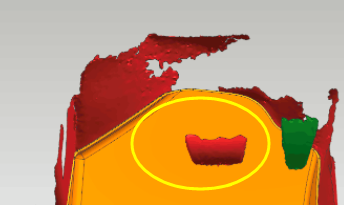

Talked to our design and test departments.
This is our design picture, the red one in the circle is the gas pedal.
There is enough space so the mats won't stock the pedal normally.
And we will keep in touch with the customer to fix out what happened in the rare situation.

The green one is the gas pedal, if they came straight across and as high as the brake pedal area there would be no interferences. This only seems to happen if adjustable pedal is on lowest setting, once raised the pedal does not go to the floor any more and wont get stuck under mat.
If this does get a redesign have them add a few more inches to the passenger side also!

Wrong typo, yeah, the green one is gas pedal.

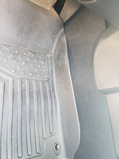

Thanks for the posts about this issue with the gas pedal getting caught ...
Didn't really think it would be an issue but ... went and checked it on my 2018 Ram 1500 Laramie (4th gen) with Adjustable Pedals and can definitely see how this can happen if pushed all the way down with these mats (I ordered mine 8/15/19). Even with the mats in the hooks it's possible to snag the pedal. See picture
Ordered mine through the link the @OEDRO vendor posted here on the forum. Definitely don't like the idea of having to cut them for pedal clearance.
Don't recall this being an issue with the Husky x-acts I had previously.
