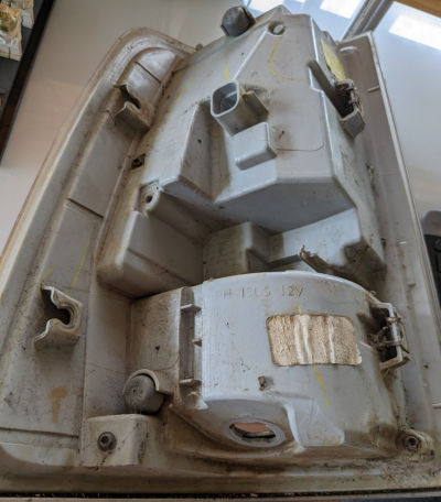

I looked after I had already purchased new bulbs for a non-LED and found that I had the factory LED (purchased the truck used). I can't find a single light and so I've decided to change the look of both on my 2017 sport. Just really hard to find as I stated and quite pricy (compared to bulbs). This thread shows the back of the OEM LED that I have https://www.ramforum.com/threads/help-with-tail-light-replacement.207523/ I just don't want to spend a fortune on the wrong lights, hence my question.

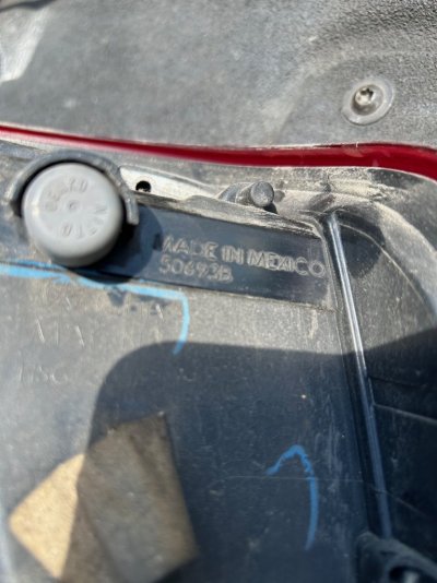

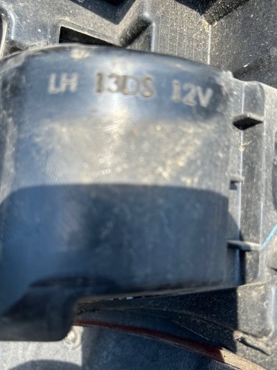

I looked really hard and these are the only two numbers that I found, neither checked out as a part number.
StateOfMind
Oct 3, 2023
334
622
Orange County CA
So that isn't a mopar number, but when I google 50593B it comes up as oem ram taillight. Looks aftermarket. Can you get a shot of the plugs?

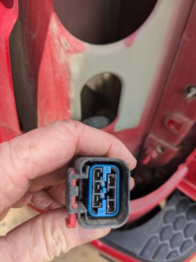

I have the same lights you have and I have the harness, problem is that I want to replace my factory led lights with a smoked led. None of the oem led's have the same harness and i need to find or make a conversion harness. Anyone know where I can get the harness i need? I currently have the 22181 harness that has two 4 pin connectors and the plug on the truck is in the attached picture. I can rewire it, but, I would prefer a premade harness.
Have you thought of tinting your current taillights yourself? That way you know the plugs will match with no issues.

found some sets with the correct plugs, but, how would I tint the ones I have?
ric221
Nov 18, 2013
284
237
There is a Product called Night Shade. It is a Black translucent paint used for tinting lights. Goes on in light coats to achieve the level of darkness that you want. There are probably some Y/T videos you could watch, to see if this is something you might want to try.
