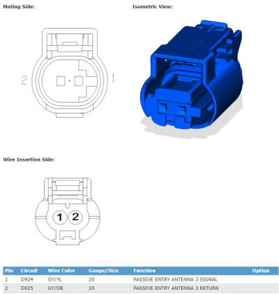

The only thing bad I have to say is the Harness that goes from the new RF hub to the new front and rear antennas is the connector that goes to these antennas is not the oem connector and is more of a pressure fit versus a lock on connector .
I brought this up to there attention .
I was wondering if anybody new what the connector would be and the female pins required for me to plug into the new antennas ?It would be a two pin connector shell and two female pins . I plan to redue the ends so it locks in correctly .

Thanks for the response on the connectors.
Yeah wasn’t sure why they don’t put the correct plug on the end .It was red plug that slid inside .

I doubt the new RF hubs are set to 0000, would make it too easy to steal cars by breaking a window and throwing in a new hub. NP on the connectors, took me 2 seconds to look up.. not sure why they didnt do that :crazy:

Thanks for the replies and insight everyone! Shared the bit about the connectors and terminals with my boss, we're gonna try them out! We're constantly trying to improve our products with hopes of reaching more people. We hope you all stay interested! We're still looking into making our kits available for a wider range of vehicles.

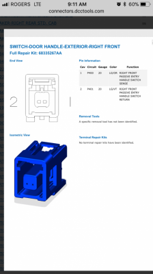

So here is the wire connector that connectors to the exterior door handle I believe .
I just don’t know how to reference the repair kit to a mousor part number .
I’m trying to add this to my setup for the push start setup .
Any help would be appreciated .
Thanks
