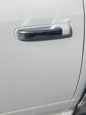

On there website it shows it being
1359 .
That is what I have Except I got my own handles with chrome,painted white .
Auto tech said they can get door handles to match your existing rear door handles .
These are pics of my front and rear door handles .
