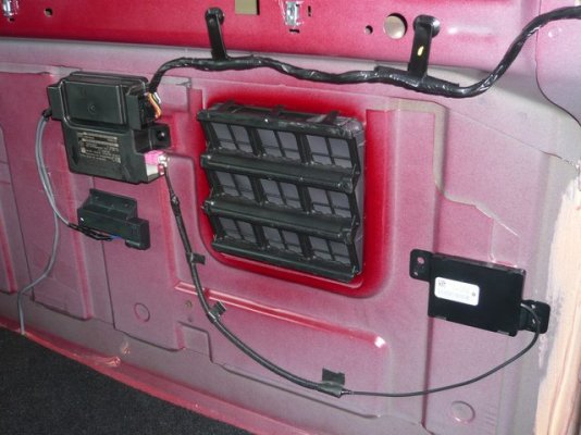

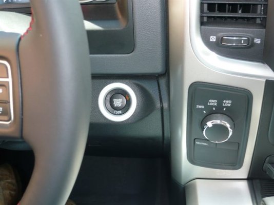

X2 what Mike said. I installed this 2 weeks ago. Took a couple of pics when I did it. First pic: top on the left is the new RFH hub (pink connector on the right side is where remote start antennae plugs in). It replaces your original RFH hub in the same location. Just below the RFH hub is one of 2 antennas you install. It is simply held onto the rear metal bulkhead with 3M adhesive tape that is used for auto trim. One goes on the back wall as shown and the second you place up front under your dash or console. Then switch out the WIN module.
402149[/ATTACH]']z49GJZNl.jpg
402151[/ATTACH]']AMvdKFJl.jpg[/QUOTE]
406207[/ATTACH]']z49GJZNl.jpg
About to attempt this also, but I have a question that hopefully someone smarter than I am can answer. How does a person remove that back panel/trim to access this? I've tried looking it up several times, but without knowing what its called I've had no luck.
416309[/ATTACH]']z49GJZNl.jpg
416311[/ATTACH]']AMvdKFJl.jpg
[/QUOTE]
Man looks good. I'm jealous lol. I have a few questions if you're able to answer. I'm trying to put together a parts list to do this without laying out for an expensive kit. Like the hood latch assy. You honestly don't need it. You can just ground pin 11 of the BCM connector with a 1k ohm resistor. The remote start ant that plugs in the new rf hub. Is it the same or is it different? What I was wondering tho if you had the part numbers for

Cillys.......I bought the kit from a company called Autotechelectronics, so what info follows is from what they sent me. Keep in mind that I have a 2017 Ram 2500.
1) The pushbutton start button is a called a WIN module and the part number you have is correct 6CK46DX9AC
2) The part number for the antenna is also the same, you need 2 of 56046958AA
3) The RFH hub....this is where things get somewhat gummed up and confusing. So let me try to explain. Up until 2016 Rams with remote start had a separate remote start antenna that was mounted on the passenger side up by the back window behind the headliner. Starting in 2017 Ram switched to an RFH hub that INCLUDED inside of it the remote start antenna, doing away with the separate remote antenna that was mounted up on the passenger side.
So when I did this mod the company sent me an RFH hub from a 2016. This caused a problem for me and why you see in the picture I posted a remote antenna (that connects to that pink connector). The 2016 RFH hub they sent did NOT have the remote antenna built in like an RFH hub for a 2017 would. Now like I said my Ram is a 2017. So when I installed the 2016 RFH hub from the kit I now had NO remote antenna. The company I bought the kit from at first did not realize this RFH hub change until I contacted them. They then supplied the remote antenna and I had to ADD it.
I explain all of this because you end up in being able to do this mod 2 ways. First-use an RFH hub for Ram's 2017 and newer that has the remote antenna built in, or Second- use an RFH hub for a Ram 2016 and older and add the remote start antenna which is what I ended up doing because the kit I got had the 2016 RFH hub instead of a 2017 one.
Unfortunately I do not have the part number for the 2016 RFH hub that my kit included, nor of the remote start antenna that I had to add but you should be able to find those part numbers if you decide to do it this way. I also do not have the part number for the 2017 RFH hub that INCLUDES the remote start antenna and is keyless go capable. I can only surmise that the differences in pricing you got for the RFH hubs is because the more expensive RFH hub is the one having the remote start antenna built in.
Keep in mind that you will also need to make changes in the RFH hub for the keyless go to function.
Feel free to ask any questions you may still have................

yes I already had remote start and remote entry. I pasted below pics of my ORIGINAL RFH hub. You will notice it does not have the connection on the right side for a remote antenna to hook up. Compare it to the pic I pasted in this thread earlier that shows the 2016 RFH hub and the pink connector for the remote antenna.
416315[/ATTACH]']YaPTSFAl.png
416317[/ATTACH]']4e2CTuhl.png
