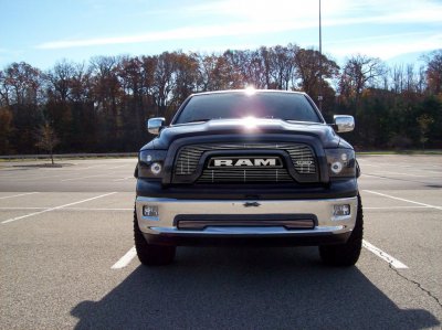

I uploaded a photoshop that my graphic design buddy at work made for me...this is what the Rebel grill would look like on my actual truck after being painted and after the billet inserts installation.

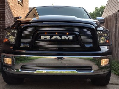

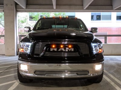

But here it is...one pic with the lights off and one with them on.

While I can't be 100% sure because my body shop guy did it all without me being there (and because I'm not the most mechanically-inclined person to say the very least), the best way I can describe what he told me about how he got it to work would be the following...
The top of the grill matched up fine without issue...mounting points and brackets were a match so no work needed there. Width-wise its the same as the 2012 grill so no trimming needed on the sides or around the headlights.
As for the bottom...yes that is where some of the body-shop skills came into play because the Rebel grill is about an inch or so taller. So...to make it work:
I have the standard chrome Big Horn bumper and on top of it...where the grill meets the bumper is that black (body colored) area. I believe that is just part of the bumper assembly...perhaps a cover. He trimmed the edge of it a little bit so that the bottom portion of the grill would not need as much trimming. He did, however, also trim a little off the bottom of the grill as well. He then got a piece of black painted trim/molding to put across the bottom of the newly trimmed grill so that there were no rough edges showing. You can't even see it to be honest it looks awesome. As for mounting points, he temporarily removed the bottom mounting points on the back of the Rebel grill, and later reattached them in the proper spots to get them to line up correctly on my truck like the stock grill did. He used that crazy-strong adhesive (can't remember the name) that they use to hold windshields in to reattach the mounting points. As complex as this all sounds he said that the trimming/reattaching portion of this job was only a couple hours work and was fairly easy to do if you have the right tools.
The bulk of the labor was for the painting because I wanted the black matte stock appearance of the Rebel grill painted to match my glossy black truck. The other two bigger portions of the labor were for the led bulbs and the RAM emblem. The grill inserts I don't even factor in here because they took him 10 minutes to do.
The bulbs - to get the type 194/168 amber Sylvania bulbs to fit in that very narrow open space above the RAM emblem he had to trim away some of the black mesh from the back of the grill.
For the RAM emblem - he originally tried to paint the stock gray/machine color emblem that comes with the Rebel grill but it didn't turn out well. So I went online and bought the chrome version of that emblem from a Mopar seller on eBay for $56 shipped. The thing that sucked was they falsely advertise (Mopar does) that the chrome emblem (from the 2017/18 Laramie trim) will fit the Rebel backplate on the Rebel grill. It doesn't...not without some trimming. It is actually a little wider than the RAM emblem that comes with the Rebel grill but height-wise it is a match. So getting it to fit nicely was challenging for him but he got it done. He still wants to clean up a couple small areas around the "R" letter so you don't see the rough edges at all. Besides all that it is good to go.
So...in order of amount of work needed ranking from most to least:
1. Painting
2. Emblem swap
3. Led lights
4. Bottom of grill and bumper cover trimming and reattaching of mount points
He said without factoring in the painting process this job took him about 6 hours. When factoring in the painting (sanding, clear, multiple coats, etc) you are looking at about a 10-12 hour total job if you want it to look perfect. This of course did not all happen at once. He worked on my truck a little bit at a time on the weekends over the course of about a month.

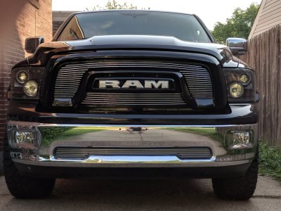

Pittsburgh
That's a more current pic of the new setup. The chrome RAM emblem has been merged in on this one unlike the last pics that still had the stock gray-ish RAM emblem that came with the Rebel grill. Also, I got some black cab roof led lights installed as well (same body shop guy). They were only $30 on Amazon and he sealed everything up really well so I'm hoping they will last awhile.
