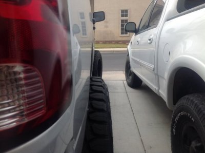

This is a 20x12 -44. They stick out about 3 inches. I don't have rock chips and my paint looks the same it did the day I put these on. But I think my next set I'll be going down to a -24.
