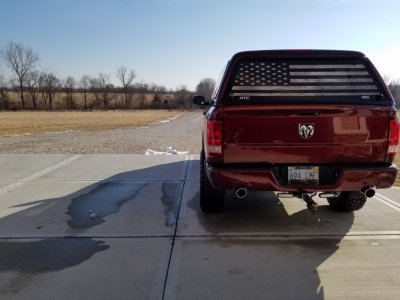

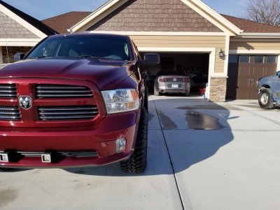

13C519C8-AA27-4E55-8D60-0341E0CD20B1.jpeg I debated in my head over offset, wanted it to look more aggressive. The wheels I wanted came in zero and +18. Couldnt locate a set with the zero. Went with a basically stock offset. I wanted no more than an inch out with no flares. Extremely happy with result.
