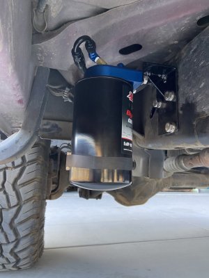

Finally got my tap in so I could mount it on the frame rail. Also used an oil filter sandwich housing as my ports were to close to get a fitting on.

How’ that bypass filter working?
