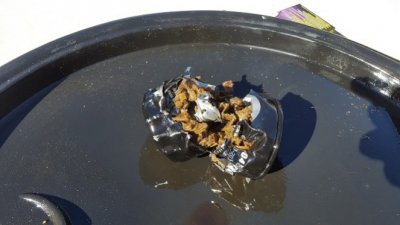

I haven't experienced a leak. I don't think they lubricate the filter gaskets at the assembly plant before they install the filters. Give how tight mine was on the truck, they must be aware of leak issues and are giving the filters an extra turn. I had a heck of a time getting mine off the first time. Since the first change, I haven't had any more issues.
Here is what it looked like after I finally got it off.
ooo god!!!
im lucky my first 5 changes are free through the dealer. using them FAST (early changes) gives me a warm fuzzy feeling. Changing my first few changes early knowing that their is always a higher amount of metal sheded off the parts in the first few thousand miles.
don't know if it helps anything, but it cant hurt and tickles my fancy
How did you end up getting that mangled mess off? I would really start worrying when the bottom starts turning and the top doesn't.

I was able to puncture the filter towards the top with a small screwdriver being careful not to damage the threads. It was tedious, but it worked.
Reading this thread about leaking filters really makes me wonder if that is why it was so difficult to remove. FCA knowing about the leaking filters may be installing them tighter than normal to prevent leaks.
Oh lawd that's a mess! Lol I remember the struggle of filters without a socket nut on my older bikes. The dang strap pullers never work so it's always a stab through it with a screwdriver and torque the entire filter off! But that's impressive the amount of destruction you laid down.
