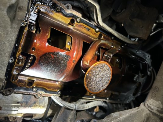

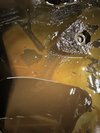

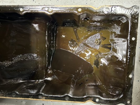

Moving the truck into the shop today (less then 100 yard and maybe 60 seconds running), high 30s for oil pressure, very normal. Cut open filter, drained oil, nothing I thought was concerning, no metal.
Dropped the pan, found less sludge and more metallic then expected… definitely some buildup on the pickup screen, seems possible enough of the other junk in the pan got pulled up onto the screen to cause the two low oil pressure instances, and then settled back down after sitting, at least to my uneducated mind? Any input from the experts here?
Will pull the timing cover tomorrow if I have time, but not expecting to find much. Tempted to pull the heads and throw a new set of lifters in while I have it this far…

Timing cover is off, pickup tube bolt sure is easy with the pan off, didn’t get to use my ground down 1/2” wrench lol. With the pickup tube off, I can see a lot more junk on there then I realized last night. It’s all plastic (or maybe aluminum, magnet didn’t stick) shavings, and looks like a lot more in the pan (hard to tell when it’s all soaked in oil). Looks like something plastic got shredded pretty good, question is what? First guess was timing guide/tensioner, they look intact that I can see but will take a closer look later. Planning on replacing both and the chain with Melling parts anyways. Can’t think of anything else plastic in the motor that could’ve been shredded into fine shavings like this, or aluminum either for that matter.
Oil pump looks normal to my inexperienced eye
Time to compile a parts order and then hopefully reassemble soon after. Decided against pulling the heads.
Why waste anymore time? That engine is toast!

As a guy who has ran a hemi 2 camshafts deep. You sir have some problems with that much in the screen even I would be tearing that thing down best of luck that engine is done if not now very soon it will blow.
