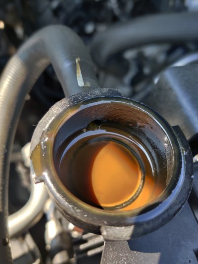

I'm out working on it now. Oil is low. Air filter is clean, I need to remove the housing on that to get a better look. Couple of pics of the coolant attached. That looks to be full but there is some junk on the dipstick. Not sure if that is worrisome or not right now.

Really tough to tell from viewing the pics from my device, but that coolant doesn't look right to me for such a new vehicle. Could engine oil be co-mingling? Like I mentioned before, the filter base mounted oil coolers have been known to leak on them.

Yep, the coolant does not look like any I have seen previously. I'm going to bring it to the shop on Tuesday. Will update based on what I learn.

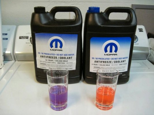

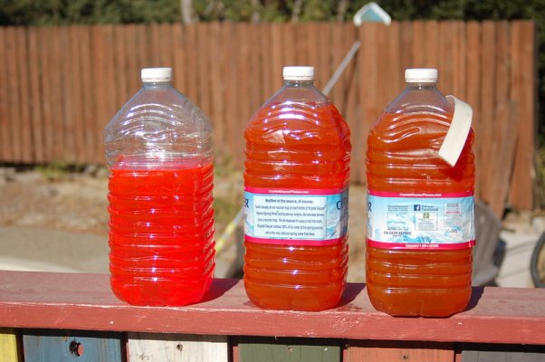

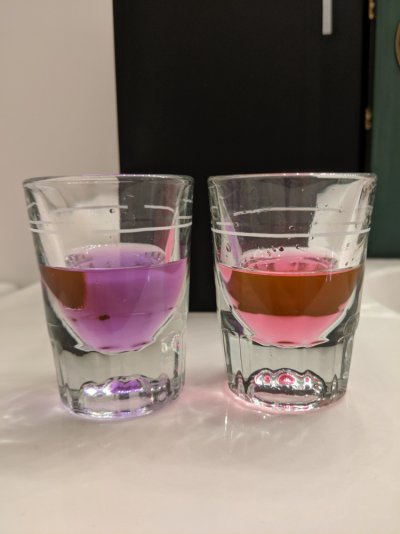

Far left is new coolant and far right is coolant after 20k miles, my truck. My question is why is your coolant that orange? It should be pink or purple. There is no way that truck should have that coolant, I never seen OAT look like that. Below is chrysler hoat, stopped in 2013. Either you have some rusting, or that is wrong coolant, I'd empty the rad and post a pic like I have there.
I could be wrong, here is a thread on it, maybe someone can clarify why is his coolant that orange.
Both these samples are chrysler oat, one new purple and used pink.
