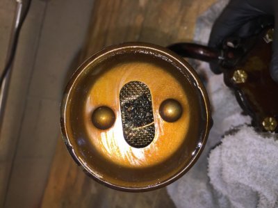

Took about 6 hours to complete but project complete. Hopefully the picture uploaded of all the junk in the screen.
When I first fired it up I was hearing the oil pump run. After it warned up it went away. Remembered I needed to add more oil due to it being the high volume pump. Took it for a good run again heard the pump running at first. Getting good pressures about 70 at first then 40-60 when warm.

Care to elaborate?
See Medic's photo to understand why I don't like them. One small spot for picking up oil and if it plugs its right under the supply tube not good at all.
Have a look at the Melling Oil Pump Screen Assemblies 265-S, full open bottom and better flowing tube.
