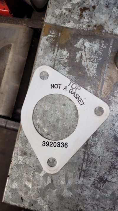

Ok I know it's a stupid question but I got a new themostat from Cummins. And it came with a plastic gasket.. Which is clearly labeled NOT A GASKET.. It will clearly fit between lift hook and inlet. Doesn't look like it will hurt anything.. should I coat it in rtv? install it as is. Or throw it in the trash. .. and what is it? Cause if there was one in the assembly originally it definitely disintegrated.
Thanks Dave

Maybe this will help.

Why would it be labeled top if it wasn’t something that you should use? That is odd . Maybe a diesel tech will enlighten us.

You haven't stated what year/engine you are referring to, or any other identifying info. I thought all 6.7L Cummins used an o-ring to seal the Tstat. The "gasket" you have pictured is a Tstat gasket, but what application, I have no idea.

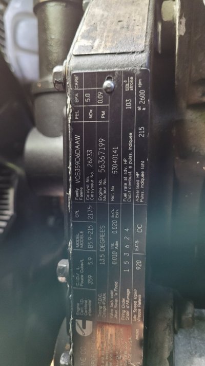

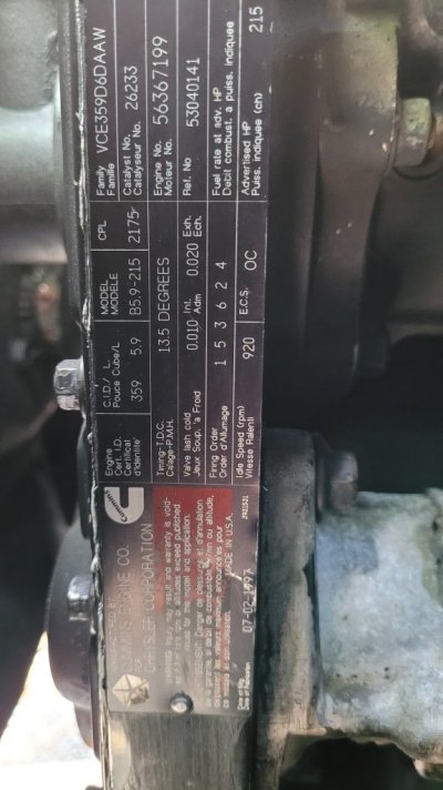

I'm sorry. You are right. It's a 97 5.9 L ..
Here

It's NOT a gasket. It is a template to ensure the thermostat opening is the correct size and shape, as there is a TSB out there detailing thermostats that didn't function correctly due to them binding in the head.
