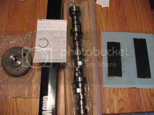

Left it alone for awhile then decided I wanted to cam it. First time around 6.1 cam reground by Stu at Inertia Motorsports. During that time I picked up my Fastman ported TB. Ran a SCT tuner through Sean. A/F wideband through AEM.

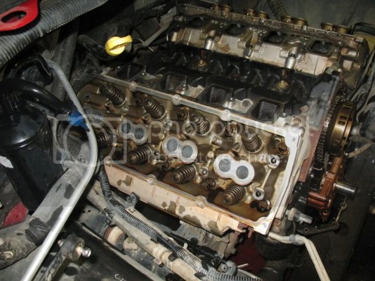

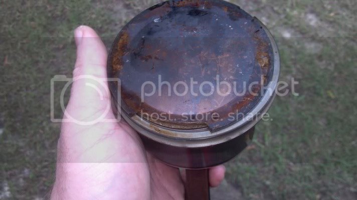

Ran the truck for a year that way and popped #3 piston racing in the sand.
Replaced the piston and rod with a new one and slipped in a Crazy Spartan from Stu on a 112 LSA. Ran SCT tune through Sean and added a AI meter. Put on a Magnaflow Y pipe.

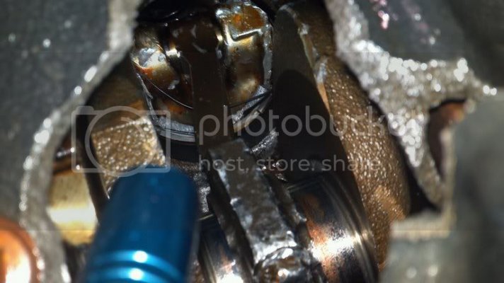

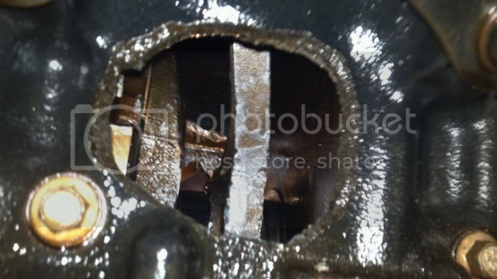

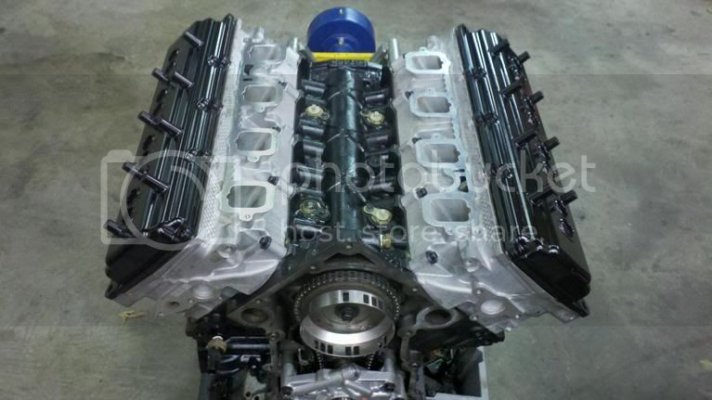

That lasted me another year till I tossed 2 rods... yay me. Sad thing is happened in the sand again.

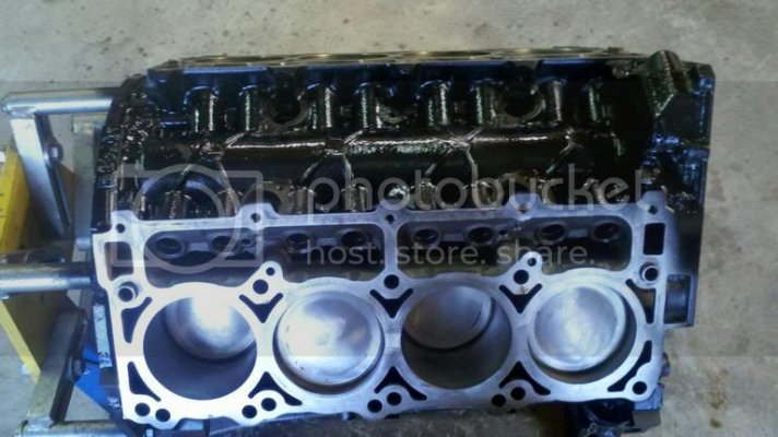

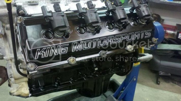

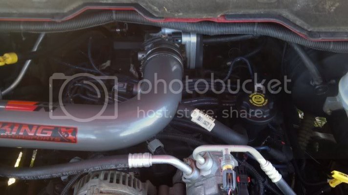

Hooked up with King Motorsports and grabbed an 06 5.7 out of a very low mile 300C. Tossed on a set of PWR heads, Pacesetter Longtubes, reused my Crazy Spartan, 6.1 injectors, ORY, Full Boar single chamber muffler dumped. Dave from EFI Spec doing my tuning with a DSP.
