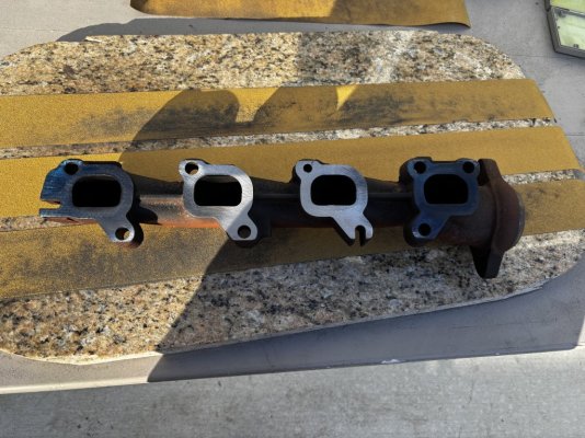

MMX MDS delete kit w/ stock spec cam. Diablo Sport Predator X used to disable MDS. Replaced the Carquest water pump with an AISIN unit. I decked the exhaust manifolds at home on a scrap piece of granite counter top with sticky back emery cloth attached. Time consuming but saved a couple bucks. They were ~.035 banana’d. Had some broken manifold bolts (knew that already). Remflex gaskets. J&L oil separator. Various new sensors. 192 beers…

Outstanding idea using the slab of granite as a flat surface and sticky back sanding belt, but whoh, what a long process..
:cheers:
I'm too lazy so it's the used (or HF) 24-36" belt sander for me. :cool:
I used a similar method to surface my heads, two 400 grit belts glued to a glass tabletop with 3M #77 adhesive.
But, belt sander definately for exhaust manifolds, you will be there all day.
