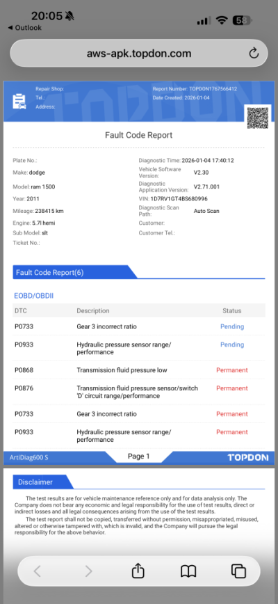

Hi everyone,
I’ve been working on my truck since last year I rebuild the engine and installed a bigger cam which ran beautifully, first oil change a bit metallic but I was expecting it, now I had a transmission line blowed in the highway and slipped on 3rd, I stopped immediately and got it towed, I close the line put the transmission fluid, and now I still having the codes that shows on the picture, my question is my transmission toast? I started looking into a new second hand one,should I just try to drain fluid change sensor and try to fill it up again?
Thank for any advice and guidance

It sounds like when the line blew, the loss of line pressure let the overdrive clutches slip until they burned up.
If I recall correctly, the 545rfe and 65rfe both use the OD clutches for 3rd gear as well.

If you have full coverage sometimes an item like this could be covered.
Fluid is now full? Do a hard reset and a quicklearn.

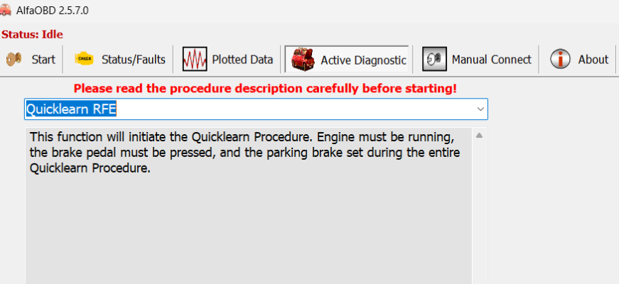

First hard reset, then get a bi directional scan tool. If it is a 2011 it is unlocked, so you don't need a code from dealer.
It isn't like a coolant line, air should be minimal if you refilled and drove and then again checked fluid hot in neutral but of course the real worry with air is not trans but torque converter. Any air bubbles on dip stick?

Nope.
Follow Burla's advice above. Use a scan tool, or AlfaOBD or something. Do a RFE quicklearn:
If that doesn't work, then start looking for a shop or local transmission rebuilder with a good reputation.
If you can do the removal/install yourself, a local rebuilder can get you up and running for a reasonable cost.

I have a topdon as600 I don’t think I can relearn the tranny with it but I will find somenthing
