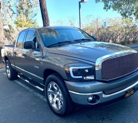

Wow, those plugs are chewed but truck looks well kept.

Nice looking Rig the older ones do have allot of body lines, hang onto it and keep taking good care of it.
