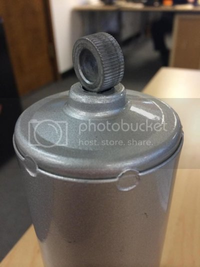

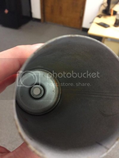

Nevermind, I'm bored on the parking lot commute home and called them. Apparently the fix "is that the dust cover should be removed before installation" and there is no additional fix.

I did it on mine (I took them off), just pull the top two nuts off, the two spacers on top, get a long screwdriver, insert under the cust cap, pop the 10mm spacer off, did both in like 2 minutes...they say thats the fix.

Have you verified that it actually worked yet? I noticed last night that one of mine finally slipped again. I'll try their fix but I can see going back to QA1's here very soon.

BellTech claims the fix for the front shocks is popping out the spacer in the dust cover. I haven't tried the "fix" as I'm really happy with the ride quality I have. I'm running the stock front shocks and BellTech's rear shocks. I also installed an AirLift kit in the rear. I'm only at 5psi now in the bags, but I really like the ride.
I put stocks on for now, havent put them back on yet.
Thats the pic I got too, wonder if they have mileage on their test truck to see if that was the fix?

I took mine apart today...both dust covers just fell off when I slid the shock out. I just left them off. We'll see what happens.

When I took my front shocks off today, the dust covers were just flopping around... They are just held in place by the bushings and washers. Front QA1s are in, still waiting for some bushings and new mopar nuts and bolts to come in for the rear.
