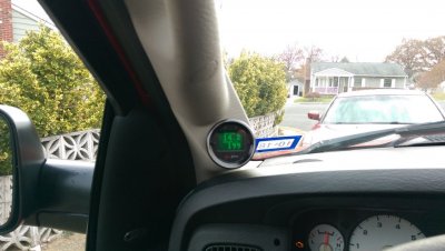

Is there a aftermarket Trans temp gauge I can install to physically monitor the temps or is there such a thing?
Lots of options here
