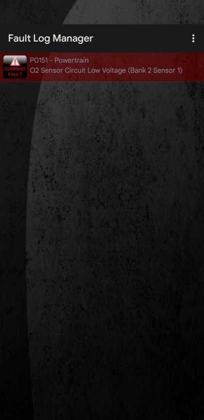

The old ****box decided to throw this at me today. :driver: a P0151 Code.
Heading out to buy a 12 pack of beer, while the penetrating oil works its magic on the O2 sensor.
I hope its just a simple swap and not some gremlin.

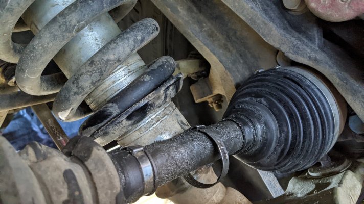

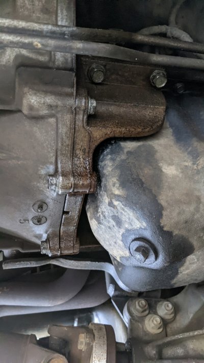

Well ****. Rear main is leaking and CV boot clamp was off ...
Pumped a bunch of grease in the boot and re-installed a new clamp in place. should be fine to finish the winter. :Big Laugh: will wait for warmer days to drop the tranny...lol...
Tested the 02 sensor and wasnt getting any voltage while heating it up , so I swapped it with the rear driver ;). Its not like they are in use with LT header...lol... No codes yet and everything seems to be running good. fingers crossed.

Maybe try some high mileage oil with seal sweller?

Well the code is back. What in that ****.lol..

The intermittent code was due to a bad connection on the O2 wire extender. **** me sideways. Glad I finally figured it out.
