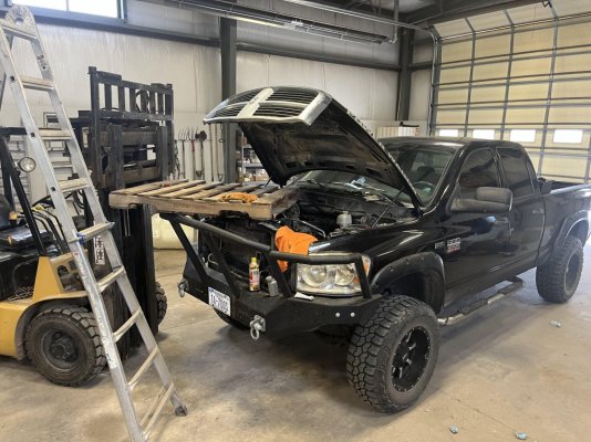

During --> After 30k miles and several years of telling myself I needed to get it done (205K mi on the odo, no idea if they've ever been done), I finally done did got my spark plugs replaced. Took me about 3 hrs, was hoping to do it in 2 but oh well. That said, it would have been 5 hrs and a lot more swearing if I didn't have access to a forklift.
I did the entire passenger side without it, and the first two pairs on the driver. Either standing on the ground or sitting in/on the bumper, the third pair would have been extremely difficult though. 4th pair towards the fire wall? No idea how it would have been physically possible to reach without the forklift. I brought the pallet in just high enough to not catch on anything, then used a ladder to get on the pallet, and had a good place to lay above the engine. Wasn't to bad with this, but not having it easily would have made those last 4 plugs take another 2 hrs.

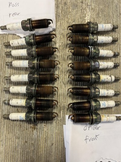

These are the take outs. Very old, dark, and eroded. Don't know if anyone has anything else to input as far as anything to keep in mind based on how these look. I know it's possible to learn a lot about how things are running from how your old plugs look, I'm just too rarded to make any judgments myself.
After: Took it out for a test drive right after completion. To my disappointment, low end still sucks. All the same issues as before. That said, high end RPM seemed to have a little more pep. Professional driver on a closed course, I did a 4wd pull on gravel up to 80mph, and once I was able to get over 30 and into the power band, it seemed to pull better than it had previously. Not sure if it was 2nd or 3rd gear, but was doing 6k RPM at 80mph but was still pulling and still sounded smooth as I let up. Did it again in 2wd and the rear was still a little floaty from a little wheel spin up until 70mph, which I'm pretty sure it wouldn't have done that before. Not saying that doing plugs gave me any real meaningful power boost, but some of those old plugs look to have a large gap so I wonder if I wasn't getting some poor ignition and perhaps it is running just a few percent better now.

Good creativity with the forklift. With out that the topside creepers are the next best thing. Bad part about those are "storing" them. Sorry I can't help on the main issue, but wish you luck with it.
