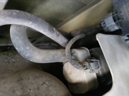

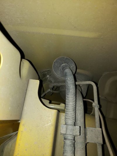

I assume since no response he fixed his. I'm in the same boat but I also go a PO456 (small leak). Problem is I can't find the freaking evac canister.... It's not in front of my fuel tank like everywhere I read. Any advise? My Ram is '15 5.7 but has 32 gallon tank, I'm guessing they put the canister elsewhere because the tank is longer.

Found it.... On top of the tank aft end. It also leads to another canister that is below the gas cap.... Everything looks good. No dryrot electrical connectors are all good... I'm at a loss. d6ed96947d5e269450cfb5a7b9364632.jpg4100b4dae28beb7241a5eb8dc1465d30.jpg
Sent from my SM-G965U using Tapatalk
Somethimes they have things like this mpounted on frame rails or under the hood, You are posting in second gen atm, but should post to the 4th gen forum. Sorry I couldnt be of more help, those guys in the 4th gen know alot though!
