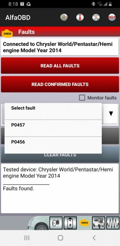

I've got a 2014 1500 with 5.7 and 150k miles that threw a p0456 and p0457, but I've already changed the purge solenoid, leak detection pump and gas cap (twice with OEM).
Anyone have a similar/same issue?Screenshot_20210707-201817_AlfaOBD.jpg
