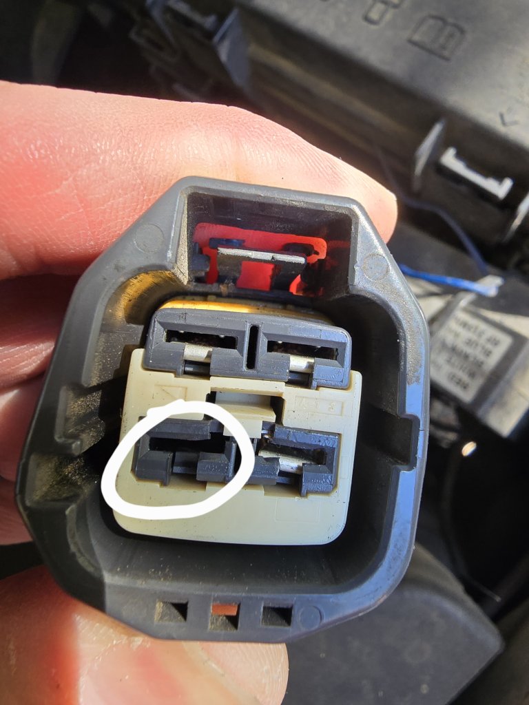

Is the plug connector missing a metal tab inside the slot circled? The fan works via battery, just not a the plug.
