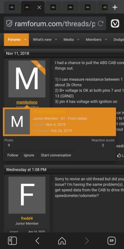

Sorry to revive an old thread but did you resolve this p0500 issue? I'm having the same problem(s). does the PCM need to get speed data from the CAB to drive the speedometer/odometer?
The OP hasn't been seen in over 6 years.
Let me see what I can dig up for you.
