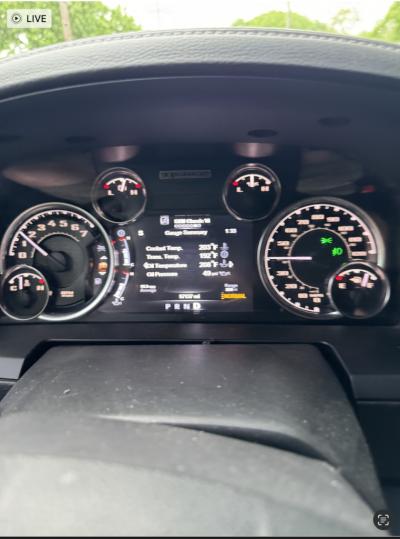

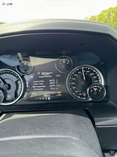

Thanks yes the two pics were not intended to be direct comparisons. I was just trying to show another member the digital display I was referring to. Trust me I was very careful to compare pressures given the same temps and rpm’s etc because I did not want to uninstall the kit. I understand pressures drop with temperature but there is a huge difference between the pressures with the kit and without under similar rpm, load and temps. I should have taken pics of pressures with both setups but I didn’t. On another note Pacbrake is paying for the return shipping which I appreciate. Maybe they’ll make changes to the kit in the future?
Thanks for all the feedback. I just wanted to give people a heads up as to my experience.

There is a large difference in oil temp between those 2 shots. The one with colder oil is going to have higher PSI all else being the same. I don't think those 2 pics are proving the kit is dropping your PSI. You'd have to test the PSI at exactly the same oil temp (down to the degree as much as possible) and same RPM as well of course.
At the numbers (PSI) he provided, I'd think he's just fine.

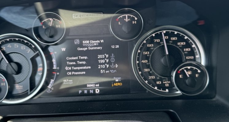

About an hour on highway, no load, full temp on everything. PacBrake kit with RP 20-820, PUP 5W20. 51 PSIView attachment 543232
That's okay,but not what i'd call great psi for that rpm. At 2500 rpm my truck is making 59/60 psi,and my totally stock 300C is making 58/59 psi using 5W-30 Redline in both.

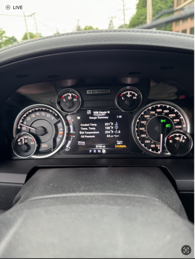

Since I really never paid any attention to my oil pressure prior to this thread! My pressures really don't vary that much! 44psi hot idle, 49psi hot @ 1500rpm and 51psi hot @ 2500rpm. Will be interesting to see if it changes on next oil change when I switch to 5w30.
